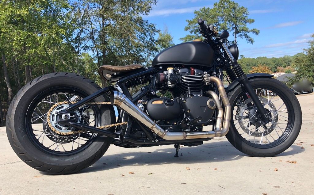

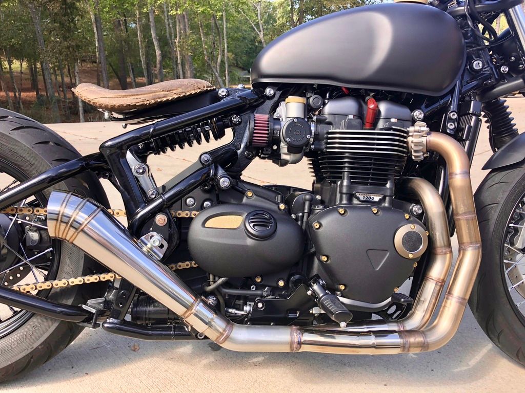

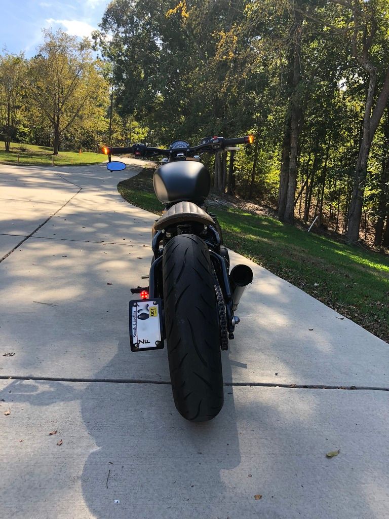

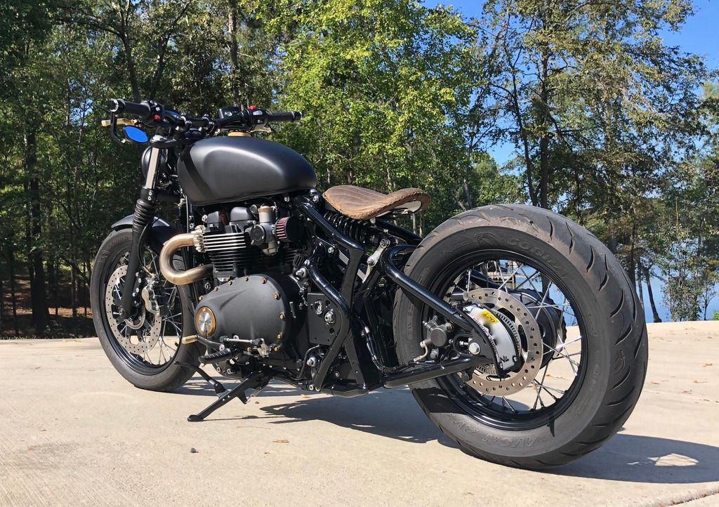

I finally got around to getting some more things done and getting some good pics of the bike. It started as a 2017 Bobber. The goal was make it look as retro/old school as possible. I wanted to remove or minimize as much as possible. I tried to black out most covers and use brass when possible for accents. I had to “patina” some pieces (like the levers) and think when the little brass pieces start to oxidize, it will pull it all together. I’m 95% done. I will probably put a very short rear fender (original cut down to maybe an inch past the seat) back on, maybe forward controls, more brass accents, and probably get another seat (similar but about 2” longer). Finally, I wanted to thank Daniel Ludwigsen (Ludwigsen Motor Company) for most of the heavy lifting (exhaust, brake upgrade, powder coating, battery/ignition relocation, etc) and Brian at A&J Cycles for a lot of the parts.
Mods:
-Custom 2:1 exhaust with cat delete (Ludwigsen), booster plug
-Airbox Delete (K&N 50 pods, P2M hose clamps, Uni crankcase filter dyed black)
-Battery relocation (under bike) and ignition relocation (old battery location) with custom wire cover

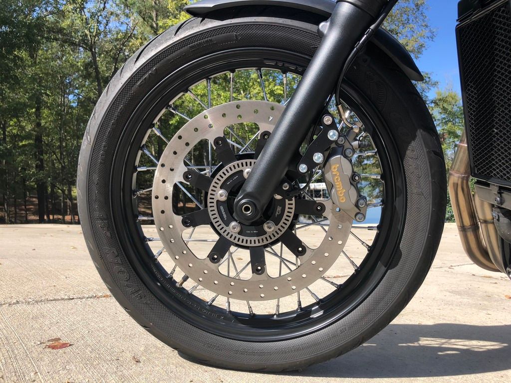

-Matris rear shock and Brembo front brake upgrade (gold caliper accent)

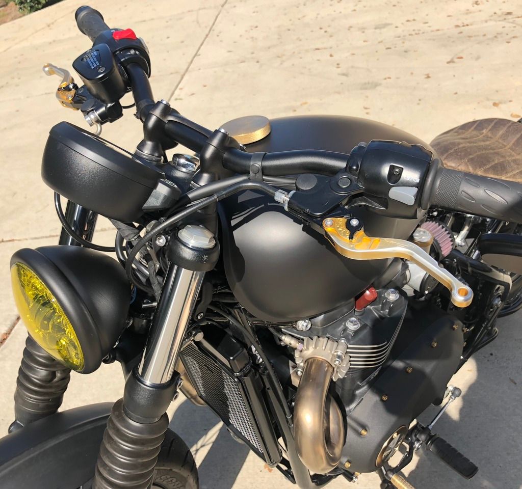

-Lighting (Motodemic adaptive with Lamin-x yellow film, Motogadget m.blaze bar end turn signals, single X-Arc running/brake on custom side mount plate)
-Paint/Powder coat flat black (tank, fenders, headlight, bars, foot levers/pegs, engine covers, etc.)
-Brass/gold accents: gas cap, shift lever, engine bolts, levers, sprocket cover mesh, drive chain
-La Rosa vintage leather seat 13”

Can you please tel me if the yellow headlamp has been achieved with a tinted vinyl or has it been sprayed?
Also... what product is it you have used and are you 100% happy with it?
I tried one of the vinyl coverings, I loved the look but couldn’t quite achieve a finish I was happy with!
33 Posts
I tinted my light yellow with film first and it was flimsy and came off after only a few weeks so i found this spray paint that gives the effect of stained glass and it works amazingly! Ill post a link to the product in just a min.

it doesnt seem like it lost any brightness but it does stand out more among a sea of regular headlights and i guess if you want it as bright as possible you can put on thinner coats of the paint.
