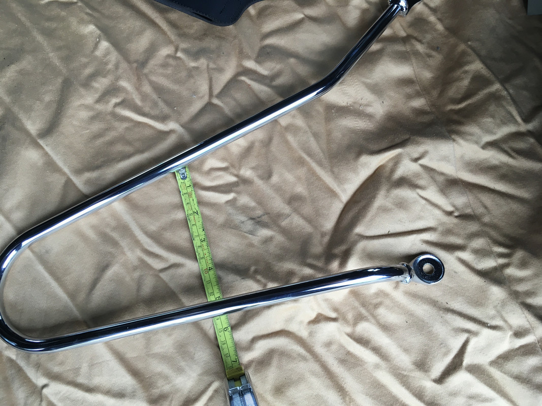

My Motone rails turned up today so straight to it...
You can see how close they are to the Thruxton rails..
I fitted the RH one to the bike

All my Stainless steel parts arrived, so I spent this evening setting up the brackets ready for welding:smile2:
I could MIG them myself, but I think TIG does a better job and I haven’t got a TIG welder, so I’ll drop em off tomorrow with a local Fabricator chap and he can get the welding done for me:nerd:
