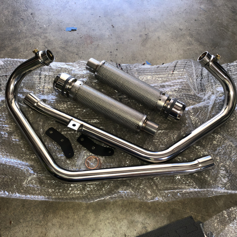

I was in the same boat as most of us in looking for info on the Delkevic exhaust. I found a single video of it running and sounded great and after speaking to a few coworkers about Delkevic, I bit the bullet and bought one.

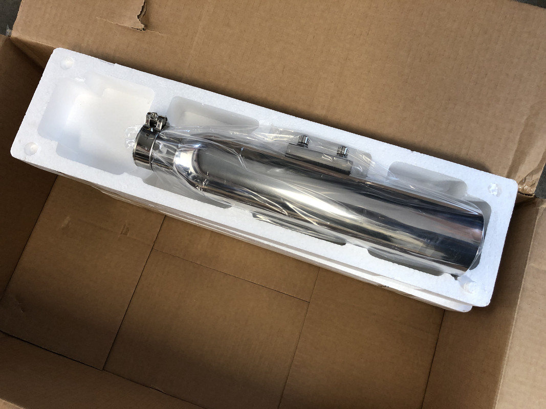

I was generally surprised how fast it shipped, made it from the mid-west to Cali in 3 days, so a point to Delkevic for the fast turn around. The exhaust was packaged pretty well and came without any damage or scratches. Un-boxing was pretty simple and easy everything looked pristine.
Now comes the hard part, the installation directions they send out are pretty vague and almost useless. If you have every worked on any thing mechanical you already know the general items. I unfortunately didn't snap enough photos during the install as I wasn't planning on the writing this up, but someone requested and figured I can do my best to help. So here we go

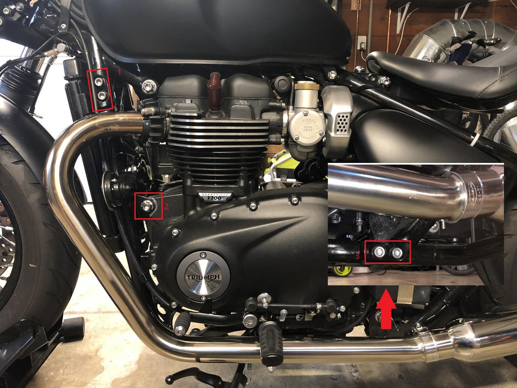

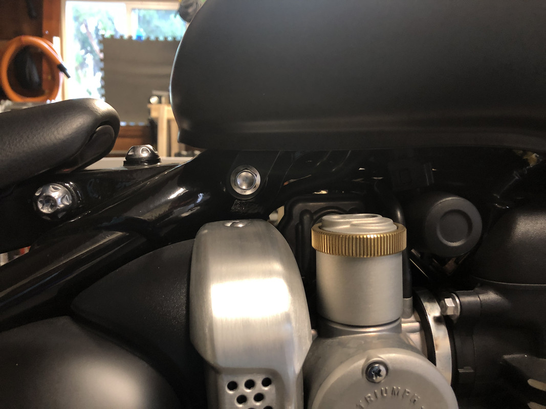

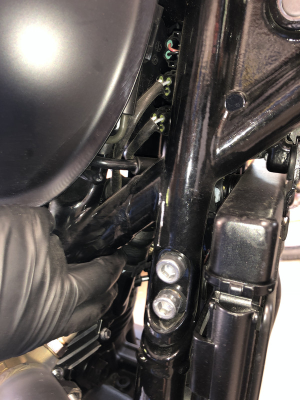

Step 1: Removing stock exhaust and Cat. Not going to go in to much detail as there are a few videos online. Only thing I want to note is that you have to undo a portion of the frame, believe me it will make your life easier. All the below fasteners have to be loosened (1 is 8 or 9mm Allen), but you have to completely remove 2 (Torx 55) and 3 (12mm) and pull the frame down. This should give you enough room to slide the cat out.

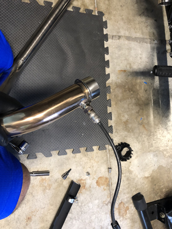

To undo the O2 sensors you have to remove the 2 fasteners hold the the tank and slide it back. This should give you enough clearance to slide a flat head in to the clips and pull the the tab up and pull the connectors out. The Upper is the Right side & Lower is the Left side.
Step 2:After everything is removed you should transfer the O2 sensors form the stock headers to the new ones. Stock O2 is 17mm and the bung in the Delkevic is a 19mm.

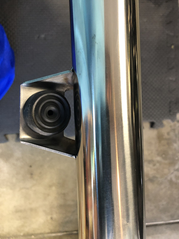

Step 4: Transfer the kick stand stop from stock pips

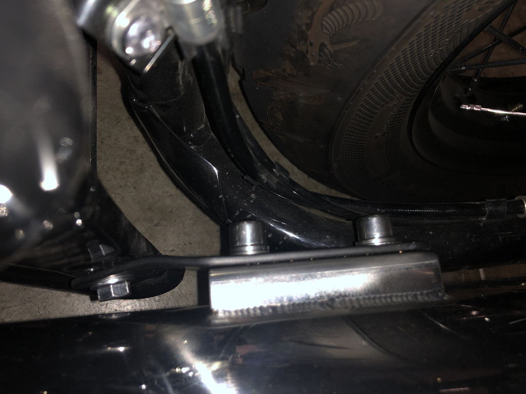

Step 5: Install the rear brackets to the bike. Took me a few mocks up to figure this out but Delkevic gives you no direction here. I kept everything hand tight/loose to make sure the final fitment was good. The bracket only fits one way for everything to line up.

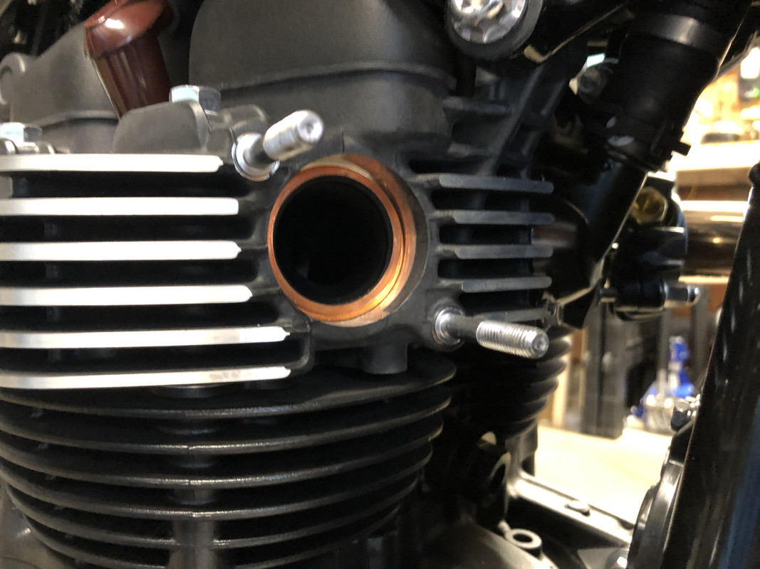

Step 6: Put the new crush gasket in the head and slide the header pipe on. Also recommend loosely installing the retaining bracket/fasteners at this time.
Step 7: Slide the muffler on to the header and install the 8mm allen fasteners thru the bracket. Make sure the band clamp is facing Allen key up. This is basically it, now you make sure everything is lined up the way you want it. I tightened everything on the following order.... Rear bracket, header, and then clamp.

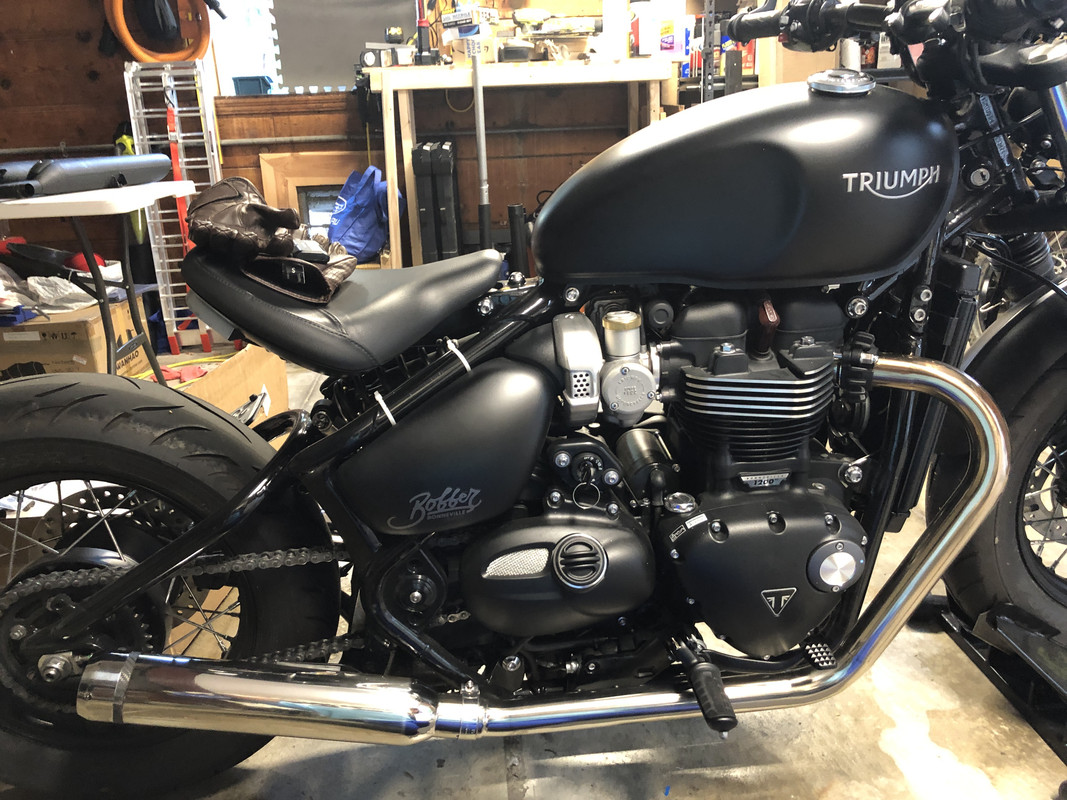

Finished product should look something like this

should be getting my replacement headers tomorrow and hoping to have time this weekend for the install (hopefully). thanks for all the help. had one question (may be silly), but i was wondering where on the stock equip was this rubber piece located? i'm not sure if i need to re-order this piece if it most likely attached to the stock pipes, since i sold my orig set awhile back. is it called the kickstand bump/stop or something?
i was looking at all the triumph parts diagrams and could not find this piece/part#.
